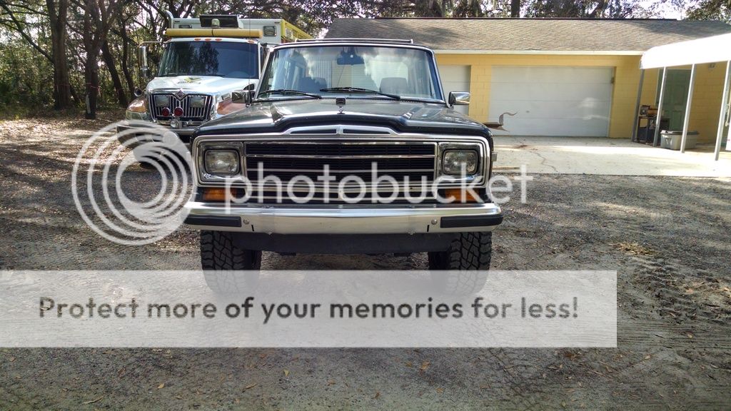

Here is the 82 before the parts yanking began.
And the 89 as it got home.

Well it has been way to long since I had the time to get on this sight, or any other, to join in on the fun. About 3 years ago our family sold our long time homestead and we had to find a new place and move. I have been trying to get property subdivided [fighting with the county] to relocate the family to. Another crappy part is I don't have a shop at my new [temporary] place.
I had just enough time to get it running and driving before the move. The poor Wag has been just sitting around all bored patiently waiting for me. Luckily a buddy of mine has a shop and said to bring it out and get to work on it. So I am back at it hopefully to finish it up.
