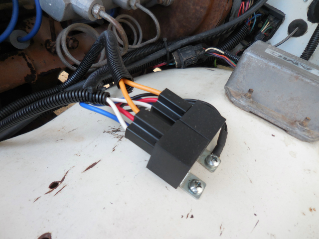

I am planning on installing relays for low and high beam headlights on my 82 Waggy. I had read a few articles about this. Only one thing confuses me a bit. The placement of the relays as it relates to the battery/power source. Most articles don’t talk about this at all. But a couple were adamant that the relays need to be as close as possible to the battery with short leads. Just wondering how critical this is. I mean you have to run wires from one side to the other to access the headlight harness. But a single 12gauge is a lot easier than 2 14 gauge loops.
Interested to hear opinions and experiences
TYIA
GRIZZ

You want a single large gauge wire to feed the relays (say 10 ga), and place the relays as close to the lights as possible. Protect the feed wire with a fuse or circuit breaker, as close to the battery as possible.
The main difference between big and small wire is the resistance per foot. Big wire has much lower resistance than small wire. Make the small wire runs as short as you can, and make the big wire runs as long as needed to make the small wire runs short.
The headlight wires go across the driver's side inner fender. That's where I put my relays. My feed wire comes from the battery side of the starter solenoid, immediately to a circuit breaker, then from the right inner fender, across the firewall, and up to the front of the left inner fender where the relays are.

Well this is what happens when you get distracted
https://www.dropbox.com/s/5yp2fmemdx...%20AM.jpg?dl=0
Life lesson here folks no matter how much you tidy up your wiring and make it look all pretty. If you forget to secure it away from hot things like say exhaust manifolds your whole day can be ruined and possibly expensive...
Hopefully when the solenoid fried it did not back feed into my MSD box or my EFI ecu.
Hey but the new relays on the headlights worked great ��

Turned out to be the 14 gauge fusible link that runs from the solenoid to the back of the instrument cluster. I guess it did it’s job. So next question can I even buy a replacement or should I run a new wire with an inline fuse or circuit breaker?
I cut off the part that melted at the solenoid and put a new hoop connector on it. Connected to the solenoid and the Waggy started right up.
Electrical is definitely my weak spot....����
