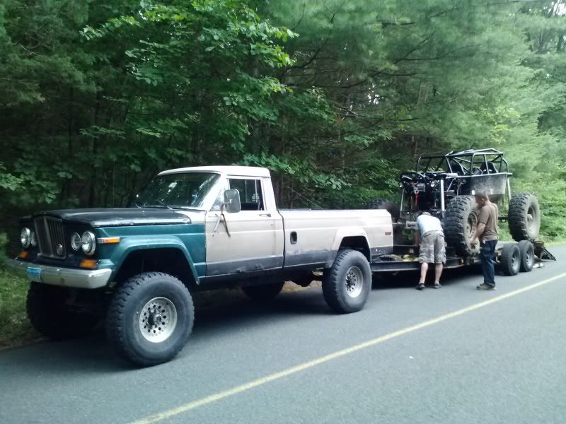

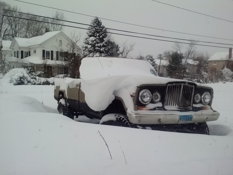

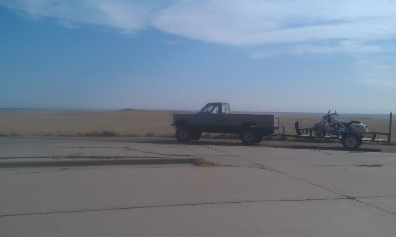

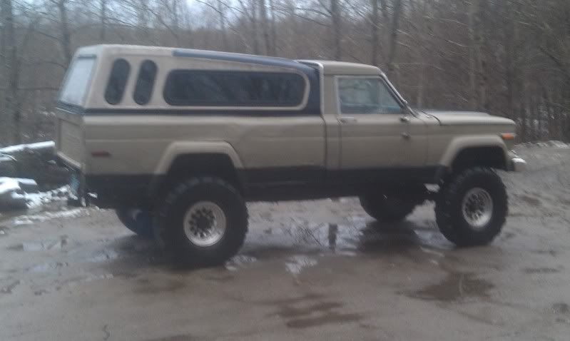

Thought I would give a reliablitity update on my truck. I have been dd this thing since putting it together and have put about 60000 miles on the setup. Had to work out numerous bugs but it hasn't let me down too bad. I been thru a NAPA clutch due to faulty pressure springs, had the fuel pump rebuilt and put in a dana 60 high pinion ford front end for some of the major stuff. The fifth gear nut slipped off the other day on my nv4500 but was a easy enough fix and i guess is a common problem. I have driven this truck cross country to sturgis SD towing a trailer with no issues and towed upwards of 10000 pounds plus of scrap metal and vehicals with no major issues. I have been gettting 20-22 mpg on the highway, I drive 100 miles round trip a day for work. So anyone looking to do this I highly recomend a cummins diesel, nv4500 transmission 1 tons and a 205 tcase for the ultimate reliable setup.

Thank you very much for posting a 60,000 mile / two year daily driver reliability update.
It's a really cool truck and it looks like you've taken it on some pretty awesome adventures.
