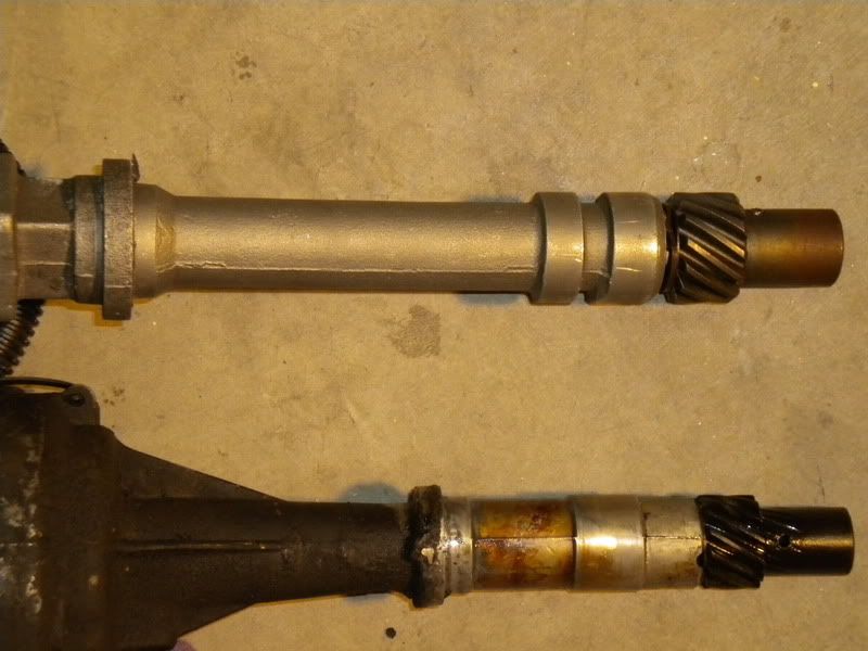

Can anyone identify this dizzy?
Just picked up an HEI used and couldn't wait to install it, but now I see problems with dimensions. I pulled out the stock dizzy and compared; the HEI shaft is way too long and too big around. The gear is too big as well. I could swap the gear, but the other dimensions are just too wrong to work.
So, I'm hoping to find out what I've got here, that way at least I know what motor this thing does actually go to. Any help is greatly appreciated.

my guess is that it is a chevy.

Kinda what I'm thinking, but wanted some input from the more experienced. Hope I can get confirmation from someone on here.

That's a standard small block Chevy HEI dizzy. Take it back.

there is no cross reference HEi for the AMC v8. they have to be made special for the application.

Well good. Anyone need a SBC HEI? Ignorance is bliss, and bliss is an expensive mistake. Maybe it's a sign I should find a new motor... JK, I'd be sleeping on the couch for a while if I suggested something like that to the wife after screwing this up.
