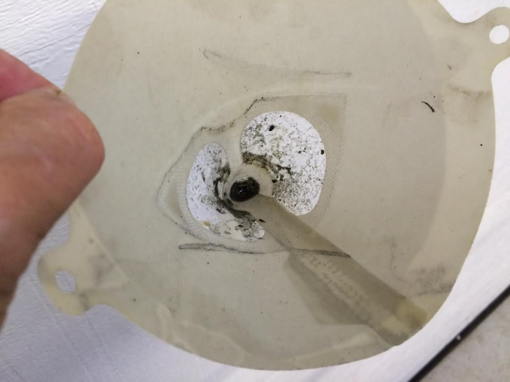

It runs! Coolant changed 3 times, oil changed once, now I just need to run another gallon of gas through it.
Here is the contamination from the first oil change. This is pretty good, it includes all of the particles that were in the oil filter as well.
