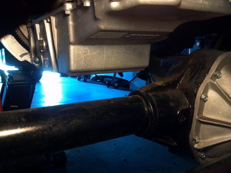

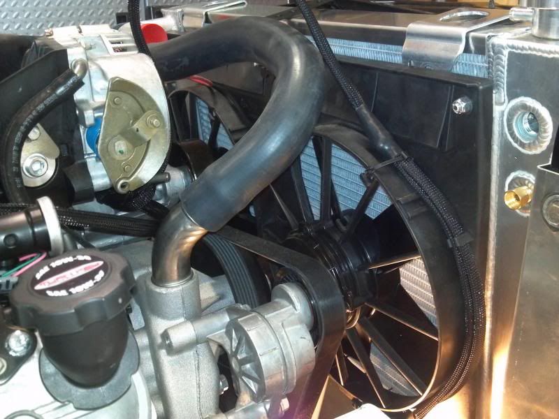

Motor swap is in full swing now! it is a GM 5.3L, 4l60E, np251 combo.
packaged and shipped very well.
custom harness made by howell, all the wires are labled.
hooker block hugger headers. i had to notch the motor mount on the passenger side for it fit, but it really wasn't a big deal.
BeCool aluminum cross flow radiator.
oil pan clearance is a bit tight so i may have to change, still planing a 2 inch lift so i will wait and see.
dual electric fans
PCM and realays for fans and fuel pump
fuse block mounted inside
