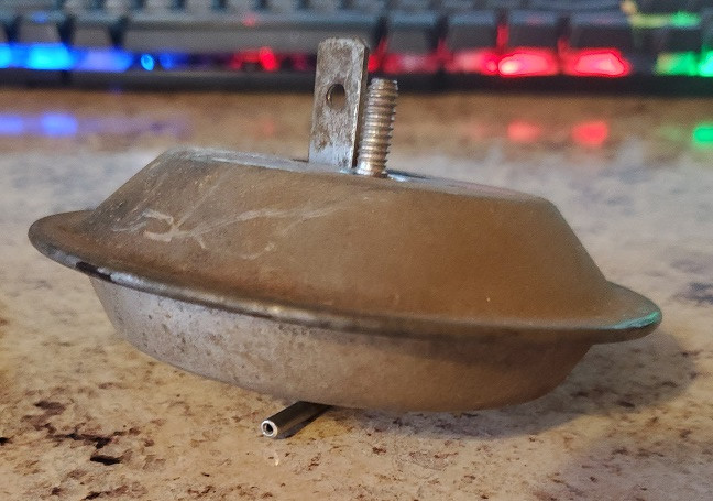

I replaced all the vacuum lines and got them all hooked up properly,
The problem now seems to be the vacuum pull off thing for the heat/defrost isn't working. It stays on defrost and wont switch to heat.
The thing just stays collapsed like when vacuum pulls it open but when you shut off the vacuum it stays in the same position. It doesn't leak vacuum though
Is there a spring inside that should push it the other way when you remove vacuum or is there a spring inside the air distribution box??
