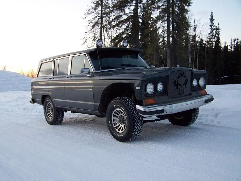

I went with the cheapo 100 watts from wally world like the bug eyes I have on top. Trimmed the hole to fit and use the rubber bushing to mount. One retainer on front and rear to hold. I had to keep the hole tight for the rubber but they haven't fallen out yet. all I'm missing in this pic is the CJ rings I just put on.
