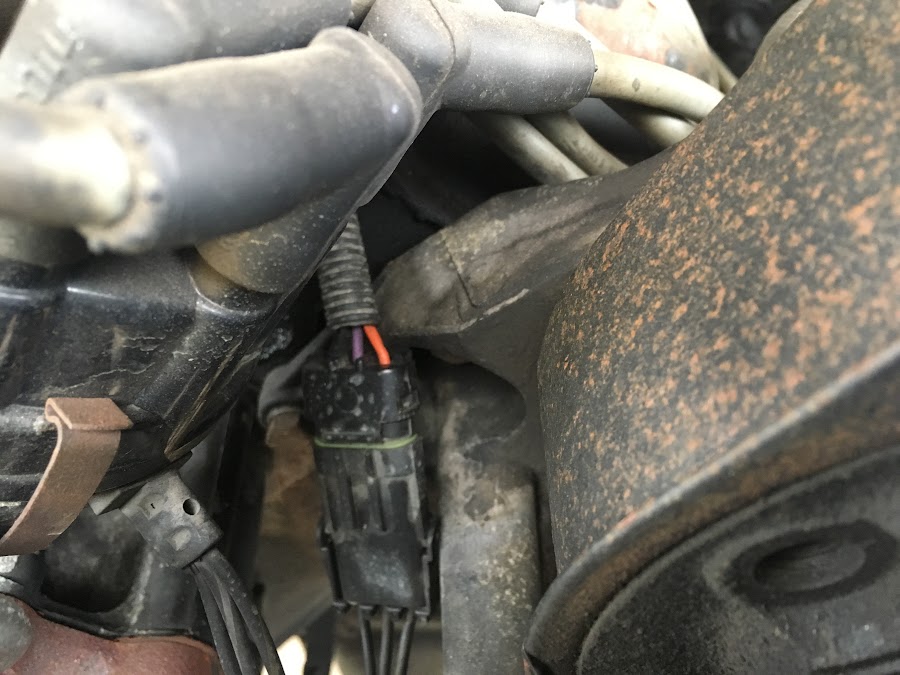

Hi Guys,
I have been searching on the web and here on the site and I cannot find the name or part# of the electrical connector in the picture.
I checked the service manual and couldn't find anything....It lays across the manifold...dont know if that is where it should be?
I just need this part, a CTO and an EGR and I should be ready for the SMOG guys...fingers crossed.
Any and all advice is appreciated.
Thanks..
http://cubeupload.com/im/geminiroq/FSJmysterypart7.jpg

that looks like the electrical connector for the distributor, motorcraft. try ford dealer.

Wiley is correct. If it’s currently running you don’t need it any longer. I cut mine off and taped the wires up when I went to fuel injection.

I don't have a part number, but I did previously look at replacing mine (before I removed the wiring) and remember it being stocked on both Amazon and at O'Reillys.

Excellent....I looked on amazon and tried all configurations, Ford distributor connector, distributor connector, automobile electrical connector...ect....and came back with nothing.
I have an orielly's a mile away....I will be heading there this afternoon
Thank you for all the help!

I always replace the crappy duraspark connectors with weatherpack.

Orielly's was not very helpful so I decided to dig some more online and I think I may have found it!
I believe it is called a
PART# 35-128
ELECTRONIC IGNITION MODULE
FORD CARS & LIGHT TRUCKS 1975 - 1985
TRUCKS 700 SERIES & LARGER 1975 - 1991
F2PZ-12A199-AA, DY683
(MAIN WIRING HARNESS)
http://www.delmarwire.com/repair-har.../ford-pigtails
Anyways....looked it up on RockAuto and found it for about 8 bucks.
Hopefull it is it?
Thanks...

If you have to look again, the application is "Duraspark II". There's a 3 terminal connector for the distributor to the Duraspark II and a 4 terminal connector for the Duraspark II to the wiring harness.

I wouldn't replace w/ DS connector if you have to buy a replacement.
Just do this...can snip them out of a GM @ boneyard cost you few bucks.
Can also buy pigtails from parts stores or online.

+1 on what Tony said. If you have to rewire the connectors anyway, don't use 1950s tech. The Weatherpack connectors are superior in every way -- in addition to being rebuildable (just need new pins and seals).
Buy one of these kits and be done with it. For the 3-wire connection at the distributor, just leave one of the ports blank on both sides.

The original Ford plastic connector on the distributor side falls apart pretty readily. Weatherpack is much better.

Thanks to everyone for all the advice....I will look into the weather pack kit in the link.
