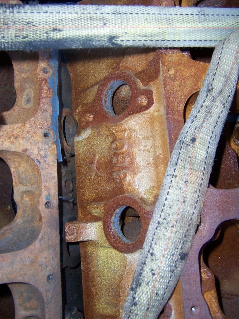

Not to burst anyone's bubble but I bought a 360 service block a few years ago and that is exactly what it is. It is a 360 block with the 360 embossment on the side of it. Absolutely nothing special other the little aluminum tag wired to it with no numbers on it what so ever.
Not sure if it's the same, but I'm pulling the engine in what's left of my Dad's 78 J20, it had a new short block from the dealer at one point in it's life, still have the OE one on the shop floor, it too is stamped 360.
