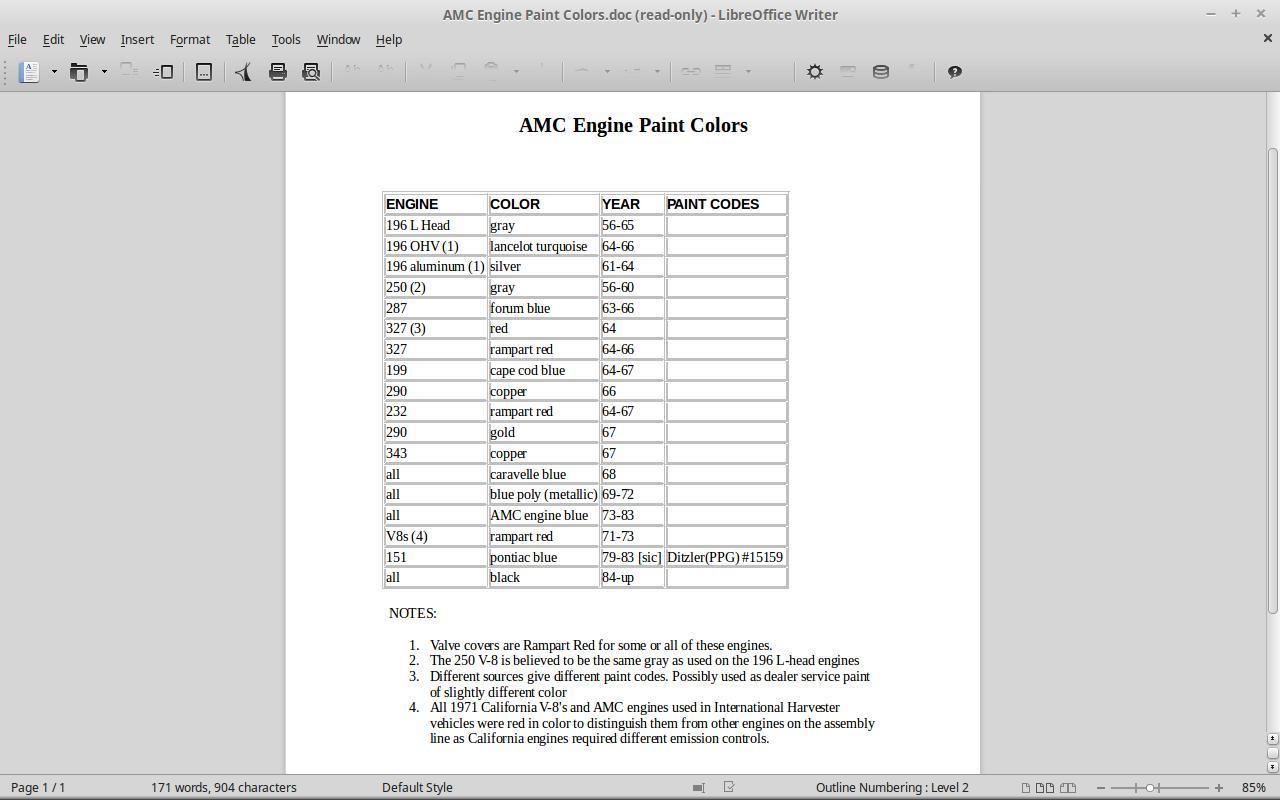

For AMC passenger car V8's:
1965-1966: "Rampart Red" for 327s (2 and 4 barrel), teal blue for 287's.
1967: Gold for 290's, Copper for 343's.
1968: "Caravelle Blue". Was an optional body color that year. It's a rich, deep, metallic blue.
1969-1973: "AMC Engine Blue". It's a teal blue metallic.
1971-1973 California: "Rampart Red".
1974-198something: "AMC Engine Blue" but without the metallic. Ends up a teal blue color, but not the same as the 287.
Never trust period ads for the appearance of an engine. No 327 ever had chrome valve covers, unlike the photos. Some ads show engines in PURPLE which never happened. You just can't trust them.

Originally Posted by Carnuck
I think the high performance motors were gold colored, but Gen I and Gen II only.
Gen III were Red for CA and only 2 bbl after '77?
Pretty crazy...I researched and wrote that up sometime in the '80's.
