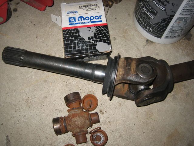

Then there's this U joint.. I "think" there may have been a problem ?? Can you tell? So a new driver U joint installed......
[IMG]http://[/IMG]
The pass U joint has been changed and felt great, so I left it alone and added some grease.
[IMG][/IMG]

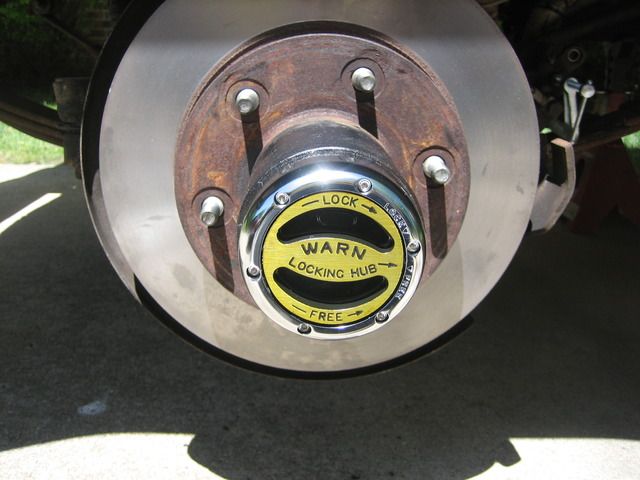

Hubs .. new units from WARN, the basic lock or Free kind. [ WARN kit/Part number 20990 ]
The WARN "Lock-O-Matics" I took off? For sale if anybody wants them.

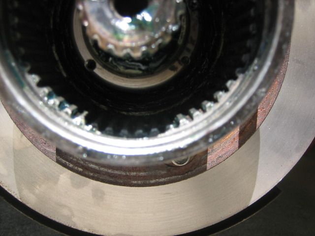

First, slide the hub body over the axle shaft, then install the large retaining lock ring on the outside of the hub. There is a groove, you just can't see it!
[IMG][/IMG]
[IMG]http://[/IMG]
THEN - install the axle shaft snap ring.. it helps to push the axle outward to get at the slot. I did this with a large screwdriver against the u joint.
Then line up and start 2 screws into the hub body, push the end cover down. I added a slight amount of grease to the O ring to ensure it slid into position well and seals. Add the other bolts, snug down. Ready for Calipers!
[IMG]http://[/IMG]
Done for the day . . .

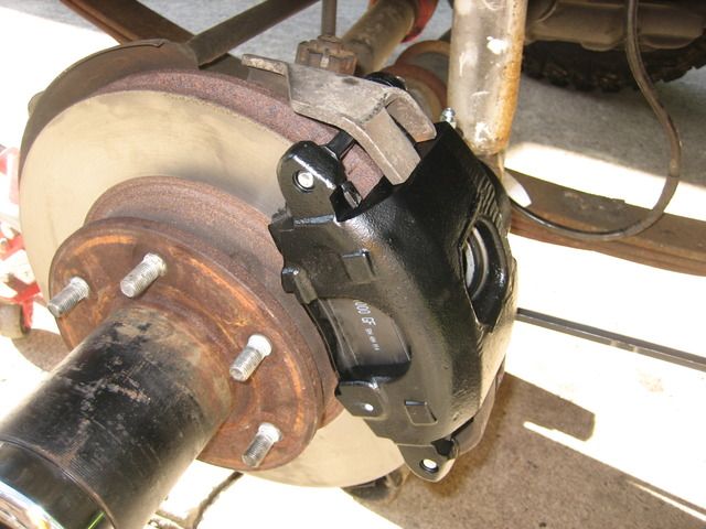

And you noticed... no brakes.
Well, seems the re-man folks at NAPA had a slight issue with one of the calipers. It had a smaller banjo bolt. So - I could not get the brakes done. They ordered and I got the correct one today. So let's proceed ...
First, I drained the 38 year old brake fluid from the front circuits. YUK. this is why I hope you all change the brake fluids once in awhile. I couldn't believe how much crud came out of the system. Remember, brake fluid is hydroscopic - ie it absorbs water over time. This results in internal rust to the system.
[IMG][/IMG]
Now the re-man caliper and pads go on . . .
[IMG][/IMG]
[IMG]http://[/IMG]
After installing the brake lines, opened up the longest line and added fluid.
[IMG][/IMG]
Gravity bled most of the air out of the system. Had a buddy come over and pump the brakes for the last bit.. and all good! Pedal is now solid and healthy!

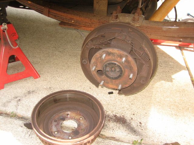

Rear brakes. Gathering all the parts I need.. I "think" Notice, decided to replace the rear wheel cylinders as well. The old ones are not leaking, but as nasty as the fluid is, want to start with all new parts. I am sure this may be the last brake job this thing gets ever.
[IMG][/IMG]
Start the disassembly process.. forgot how DIRTY rear drum brakes are.. driver side lining was on the rivets. Definitely needed to be done.
[IMG]http://[/IMG]
Get all the old stuff removed, take the drums to O'Reilys. Hmm, they say the drums can't be turned? I should have measured them myself.. not sure I am buying that. However, what I apparently am buying is 2 new drums.
I am going to double check the old drums at NAPA next week... the new ones don't have the cooling fins. China re-pops I am sure.
1 can of brake clean, some scrubbing with the small brass brush.. and ready to install parts. Rear drums are like a dynamic puzzle.. try to fit them all together and get the springs hooked up. "Lots-O-Fun" !
[IMG][/IMG]
The puzzle solved - all parts installed, ready for the drum. Notice, the new rear side pad came pre-rusted? Nice - and it was free! oh well.
[IMG][/IMG]
New drum installed, light coat of high temp paint.. ready to bleed the brakes. Which we do.. Carl stopped by to help this morning for a bit. He is a local Jeep buddy. Drain all the fluid in the rear circuit, flush with some new fluid.
Pump, bleed, pump, bleed. Pete and repeat until all air is expelled. Have pedal out the wazoo now!
Have proper brakes - with a park brake !
[IMG][/IMG]
