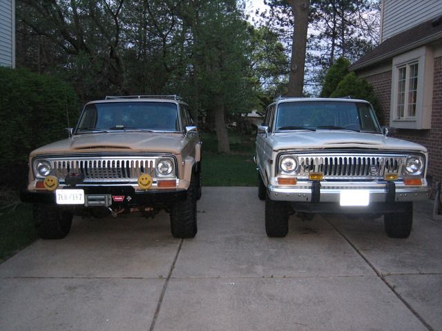

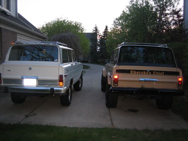

Step one:
Send the white Waggy down the road .. Heading home to Chicago now... all fixed up and ready to drive.
Was getting 7.8 mpg. Removed the vacuum stuff, got the right plugs, wires, cap, etc ....did a full proper tune up with "Old School" mentality..
Now getting 11.5 to 12 mpg. Oh yes! lol a huge improvement...
Now have a open space in my driveway.. and soon garage to start the "work", er - "FUN" !
