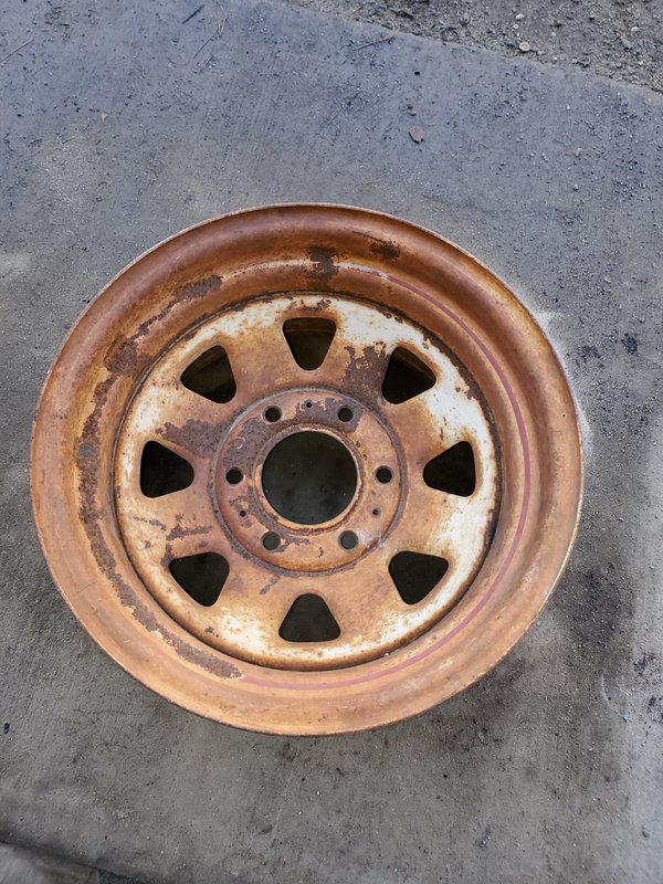

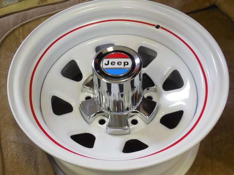

ever since I saw the black restored honcho that has been for sale all over the web for a long time, I wanted a spare tire carrier like they devised,....
I knew whether I ran chrome or white OEM wagon rims
that I wanted the spare to be white,....
this is the beginning of getting the spare rim ready,....
a really ruff rim from Kenny at WATSON AND SONS JEEP SALVAGE
in pinetown NC,....a great place to find FSJ and all Jeep parts,....

media blasted and primed with RUSTOLEUM self etching primer
I really love their products,....
I used their garage floor epoxy at home and at the shop on a 40x40 floor
great stuff, now they have a product that is even better "rock solid"
Old 09-16-2020, 12:59 PM

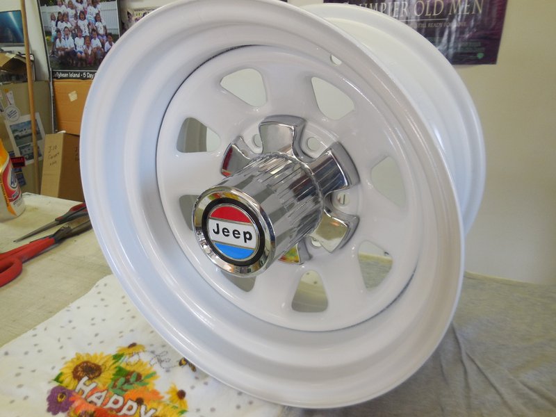

painted with,...you guessed it,...RUSTOLEUMS HIGH PERFORMANCE ENAMEL
gloss white
in the tall can
it is really better than normal paint,....I have tested it.
Old 09-16-2020, 01:03 PM
SOLSAKS's Avatar
SOLSAKS SOLSAKS is offline
Join Date: Jul 25, 2016
Location: Benson. NC
Posts: 1,651
with stripe,...
I cheated and did it with high performance super cast red vinyl
cut the entire ring and laid it on wet,.....
I am telling you guys,
this photo does more for me than any X-Rated photo ever could,....!!!
at 50, I am much more excited about a nice FSJ,.....or a glass of milk and handful
of Oreos,.... than I am in having relations,......

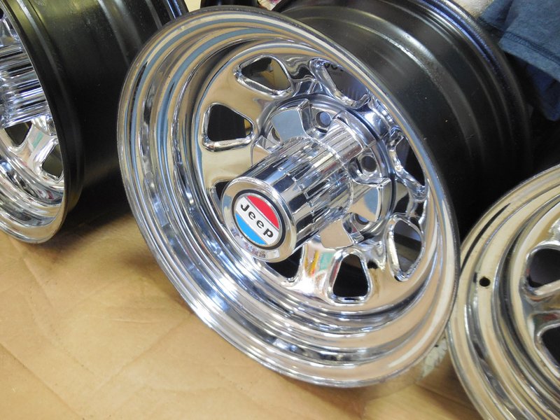

I have now completed a set of 5 white OEM wagon rims
and a set of 5 factory chrome OEM wagon rims
not sure which type I will run,.....
this is how the chrome ones looked
( got them from a great IFSJA member from Canada,...LEVELHEAD, I believe)
very nice honest cool dude...
the factory clear did its job, I stripped the clear and polished,....wow
nothing like factory chrome.....thanx for a deal levelhead....

after the clear is gone,....you get bling !!!
used some old tried and true chrome polish
NO.7 chrome polish from NAPA

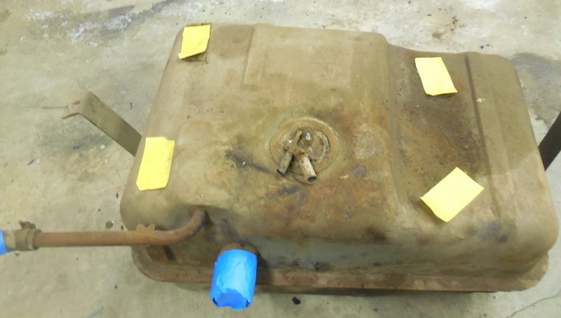

gas tank before

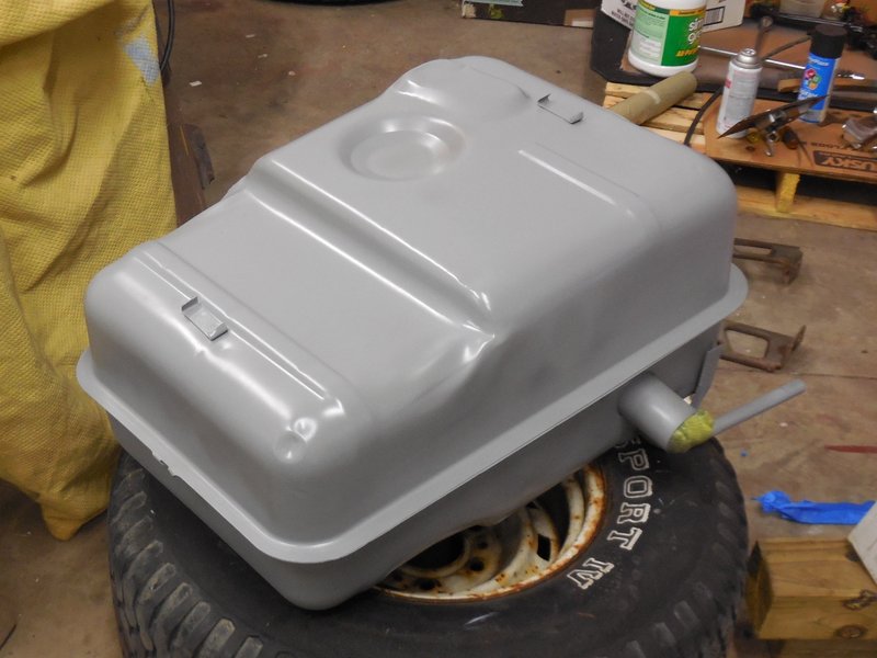

after,...
....I had used Eastwood "tank tone" in the past,
but,...decided to use a gloss grey
the metallic silver tends to fail sometimes,...

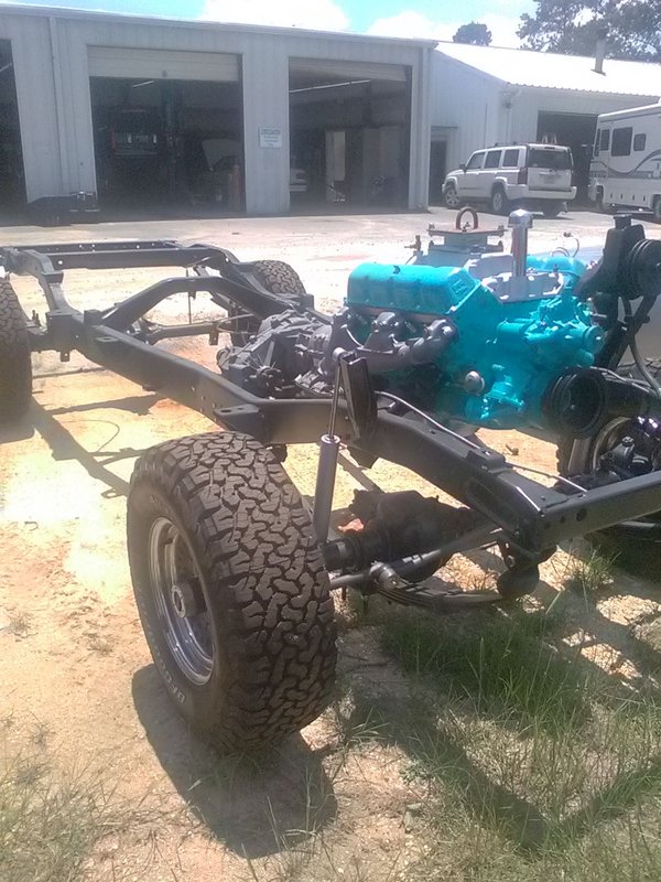

I have done several vehicles over time,...
this is the first time that I got to have a rolling chassis,
onto which we placed all other mechanical parts,....
like a new 360,....
but fate had a different plan for the powerplant,... ( fate and some knuckle heads involved with motor build/install )

Looks great Dave..... I can't believe that spare rim looks so good after. Did you pin stripe it?

thanx to:
bkilby and 78 wide-track,...I appreciate it.
pin stripe photo added,....

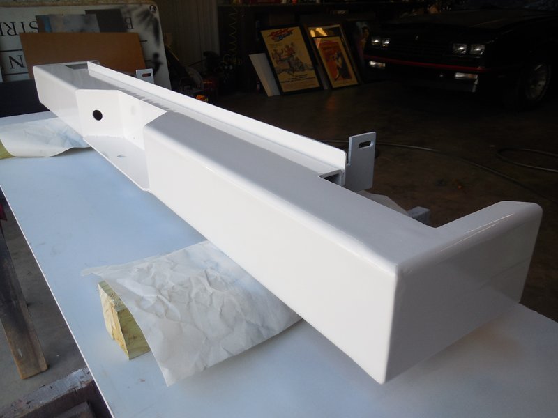

A friend who just retired from the national guard
copied the tired rear bumper
made from 1/4 and 1/2 inch steel
HEAVY HEAVY HEAVY.......feels like it weighs 300 lbs,...not sure.
primed with self etch, then filler primer
then trusty hi-performance rustoleum top coat
it will get anti skid adhesive strips, cut to shape,...
