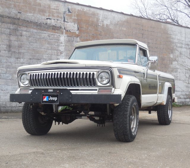

the first photo is of what I stated with,.....

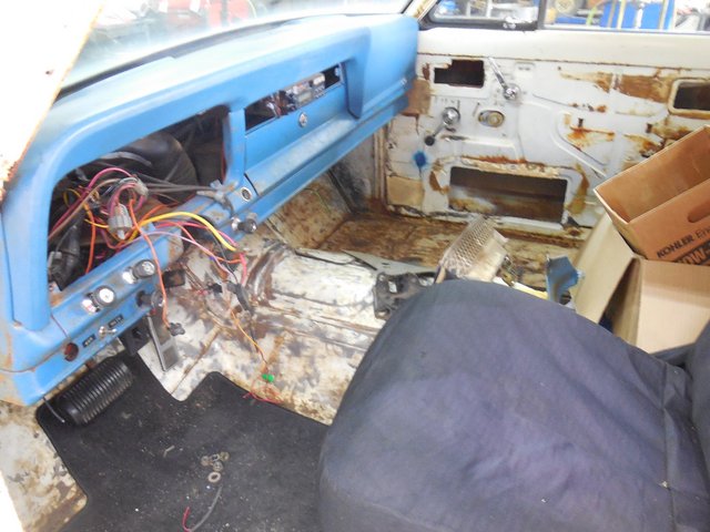

a truck from Oregon, no rot, just specks of rust all over
surface rust,....interiror had been gutted when I got it,
even tho no body rot, since it was in a wet climate, even the dash frame had
too much rust to use,.....so I got another dash frame,....
also, the wet climate saved the rubber on the vent windows,....
I cleaned them and replaced felt in the channel,.....a friend who saw them on the truck recently.....said, "if I did not know you, I would never believe they are the original seals",...they are like new, supple, etc....
all in all the truck looked like it had been used on a farm for 40+ years and lived a hard life, but that is what is was made for....now in retirement,...it gets the royal treatment and then to the rest home,...my garage.

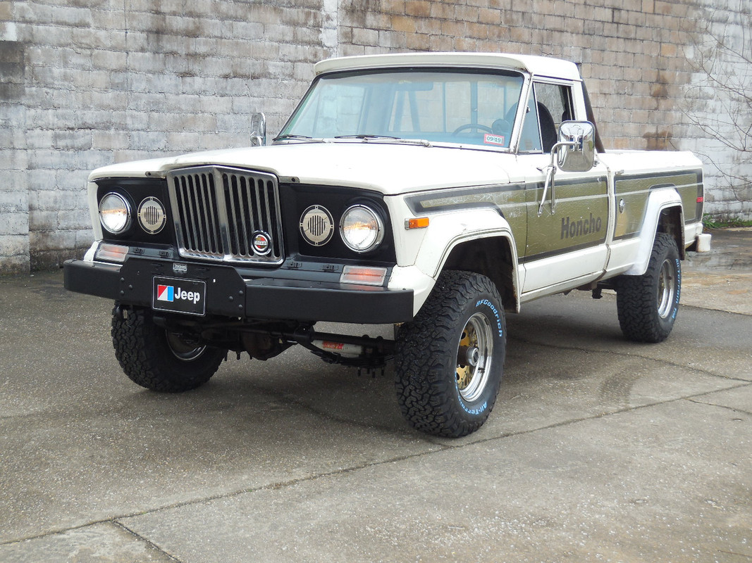

I could not wait to get the razor grille off,....
so I blacked out the front,.....
sanded and painted the WARN bumper
added some fake stainless steel pie tins that I made,....
and a tired rhino.....
also found a used round jeep badge for the rhino
and stripped and re-lettered it,....

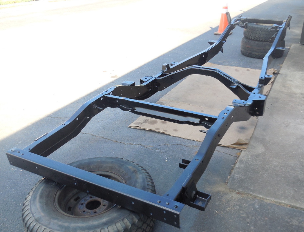

after media blasting
I used eastwoods "AFTERBLAST" it takes away the light orange surface rust that appears right after blasting,....
I put it in a spray bottle, then just blotted with a clean cloth, so I would not get so many fibers on the frame,....
will post after blast photos soon
here is the frame after priming with EASTWOOD'S rust encapsulator red oxide type primer.

painted with EASTWOODS "2K AERO-SPRAY CHASSIS BLACK"
it says it has 2 component nano ceramic technology
sprays well in a fan pattern
activated by pressing in an activator pin on bottom of can,....
I know rustoleum high performance enamel in the tall can would prob have been just as good.....
but I wanted to try the product
it seems to be a great product...
also used their can for coating the frame internally,...
not sure how good I did,....but better than nothing...

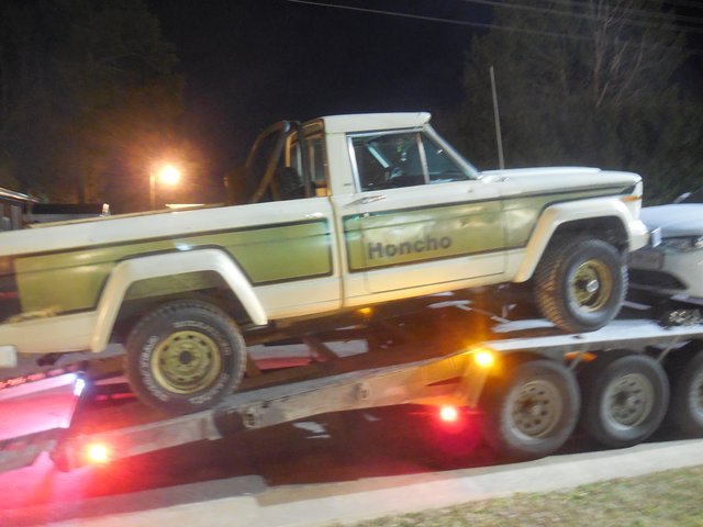

coming in from a long ride from Oregon (via New Hampshire )
it was a frigid nite !

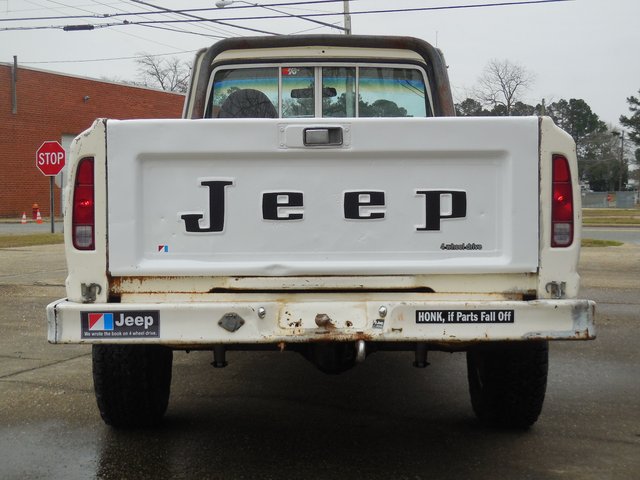

had some fun with it the few days I drove it before tear down....
( bumper stickers )
will post this tailgate for sale soon,....
it was blasted, "ospho"???? coated, then painted with rustoleum spray,....
since these are not easy to come by in any condition, someone should want it...
even tho it is kinda tired....

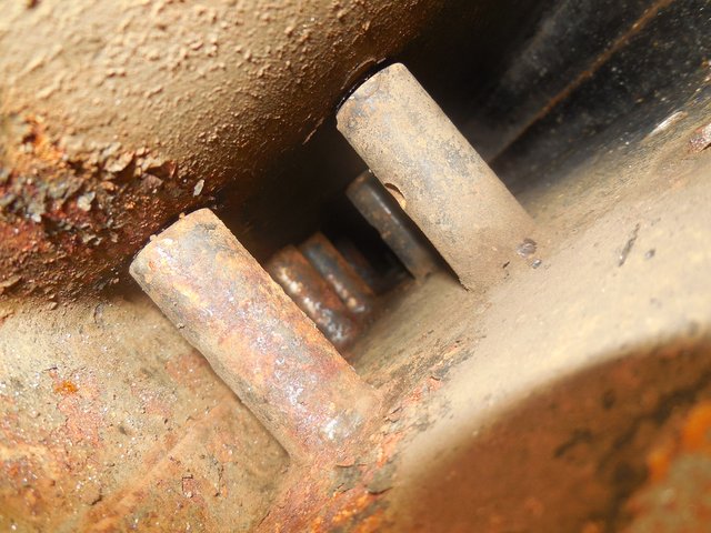

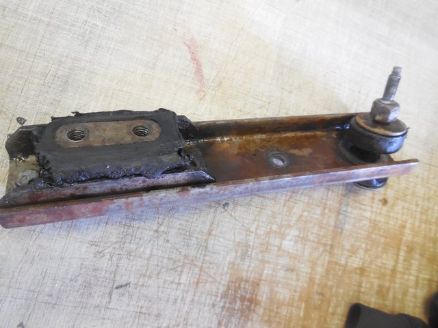

do you think these mounts need to be replaced...?

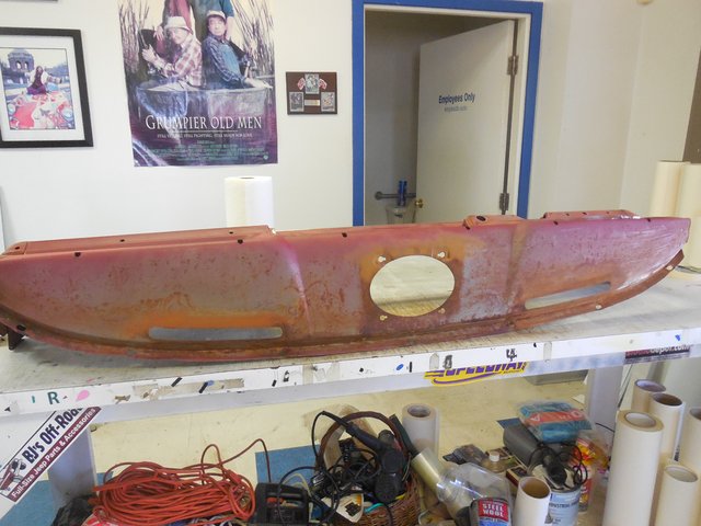

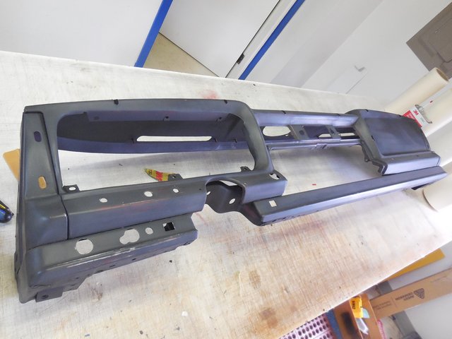

donor dash
surface rust only
wire brushed, then cleaned with purple stuff, let dry,....
Old 09-16-2020, 12:32 PM
SOLSAKS's Avatar
SOLSAKS SOLSAKS is offline
Join Date: Jul 25, 2016
Location: Benson. NC
Posts: 1,651
Old 09-16-2020, 12:34 PM
SOLSAKS's Avatar
Posts: 1,651
painted with rustoleum RUST REFORMER
waited a few days and sanded,......
final step was grey primer and a coat of KRYLON FUSION satin black,...
this is when I sanded the rustoleum rust reformer lightly before primer
