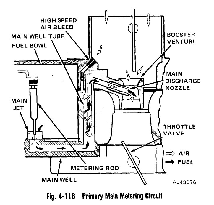

Here's the TSM:

You can see that the 4350 does not work like the other Motorcraft carburetors. The shape of the tapered metering rod determines how much fuel enters the jet.
