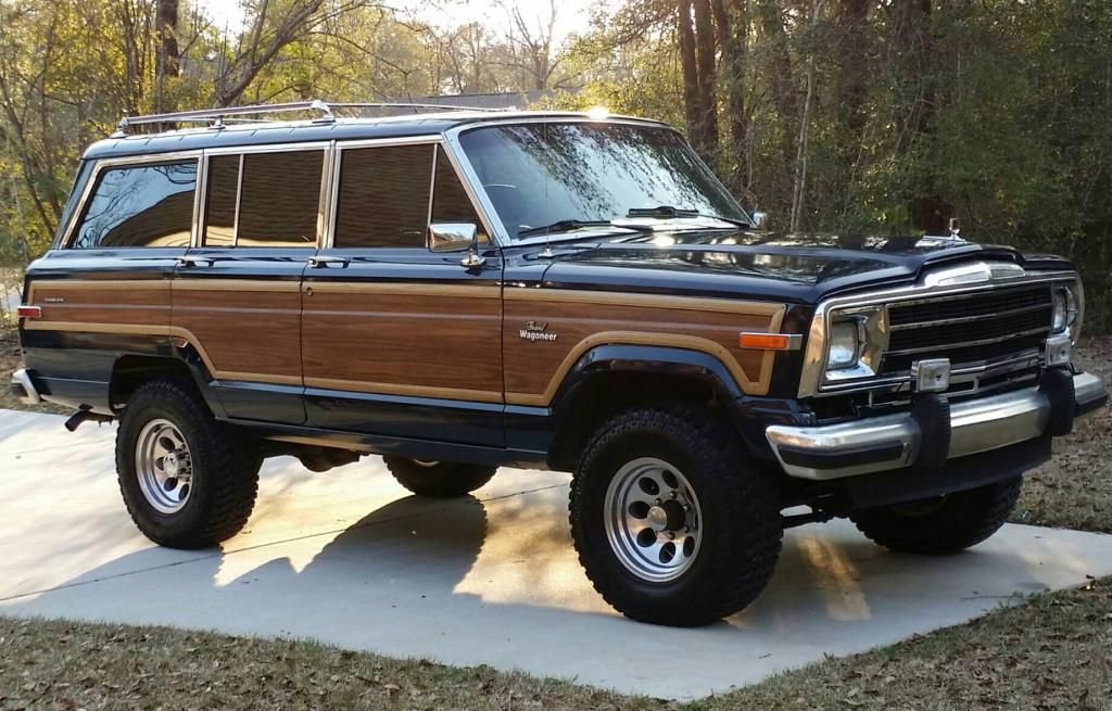

Originally Posted by earlb74
Hi, just recently I installed a Rusty's 4" lift with Goodyear 31x10.50x15 tires and so far I am very please with the look and the ride. My question is what can I do to tighten up the little bit of play in my steering. For example... If I hit a bump the steering seems to sway from one side to the other. Its not bad but I would like to fix it if possible.
Post some pics!

Originally Posted by JDD
Post some pics!
Well if it drives funny it sure looks good doing it!
