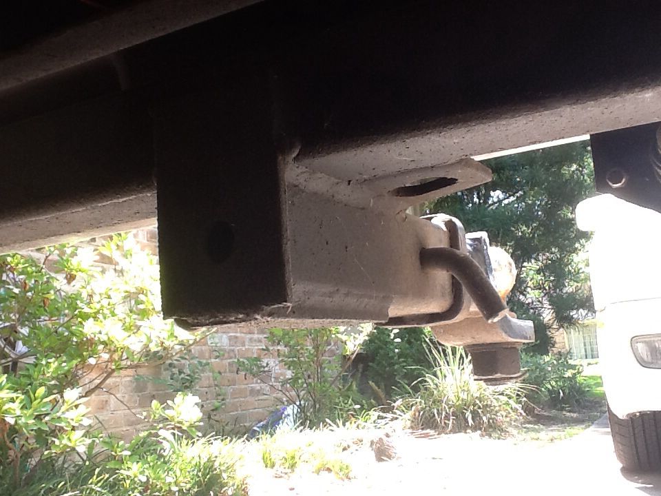

is that a trailer hitch I see there or are my eyes deceiving me?
I haven't thought about a class3/5 hitch yet, was wondering how to go about that other than "just build it"

You have good eyes. I found a couple of them for my j20 and j10 many years ago when you could still find them. They were sold through uhaul. I think they are right up there with finding a sport side bumper and end caps on the unobtanium scale now.

I figure if I can convince someone to take a couple of decent pics of the hitch (hint, hint), theres a really good welding shop here that could replicate it for me if I can't.

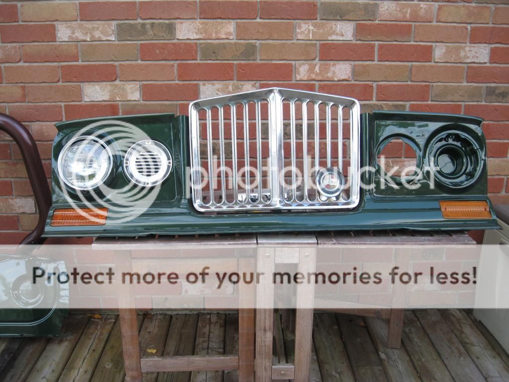

well, your picture is a bit depressing....I had two different style taillights on mine when I bought it, one looked like a cj tail light, and the other like a tractor trailer taillight.....
looking at your taillights has me wondering..
this is what I'm futz'g with when I want a break from life

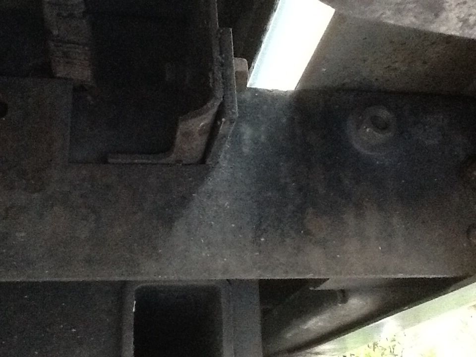

I think the hard part with hitch fabrication is the slight angle of the frame at the very back. Welding a wedge there would probably work well. A while back someone on here made five or six hitches for j trucks, but the price was way more than most wanted to pay. ($500 )

This was the hitch from my '73 J4000. It had a spare tank above it.
