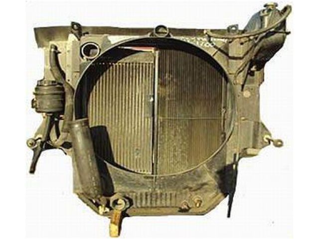

Couple questions...
What is the part number, truck that the Mishimoto intercooler came out of? I like the clean install of that one.
Also, the guys who are running intercoolers, where it appears the front valance has not been trimmed much at all, are you running the radiator in the stock location also?
As for a split Intercooler/Radiator set up I have seriously contemplated this route. Doesn't seem so bad. I crunched some numbers and to have a intercooler and radiator share the same width hole as a stock V8 radiator, but extend down a few more inches, you actually could have a greater surface area to the radiator than stock with about a 9 in wide intercooler.
Kinda set up like this, from an international truck, not the greatest picture, but you get the idea.
  #46
Old 03-01-2013, 09:50 PM
tndonor tndonor is offline
Join Date: Apr 05, 2006
Location: Denver, CO
Posts: 396
Many Cummins came with an aftercooler. It was an intercooler with coolant lines plumbed into it. They are great for stationary applications or where you done get much airflow. Same principle as mentioned in this thread.
They will never cool as much as a straight intercooler as the coolant (160-180 degrees) will be the lowest point of cooling. Some of the high horsepower guys use this thype of setup but use ice water, a circ pump, but that is only good for 1/4 mile at a time.
Unless the airflow is SEVERLY restricted or the motor will be stationary, your best cooling and horsepower gains are from a straight intercooler.

Originally Posted by Swampfox89
Couple questions...
...Also, the guys who are running intercoolers, where it appears the front valance has not been trimmed much at all, are you running the radiator in the stock location also?
My radiator is mounted in the original front/back location on the frame.
Although I had to trim my valence that was because I wanted the IC as far forward as I could get it to mount some other coolers between the IC and radiator.
If you get the two as close together as possible you can get an IC in with little or no trimming
Originally Posted by Resbum
"What year is my truck?... Which part?" Build thread- http://www.fsjnetwork.com/forum/view...p=18290#p18290
