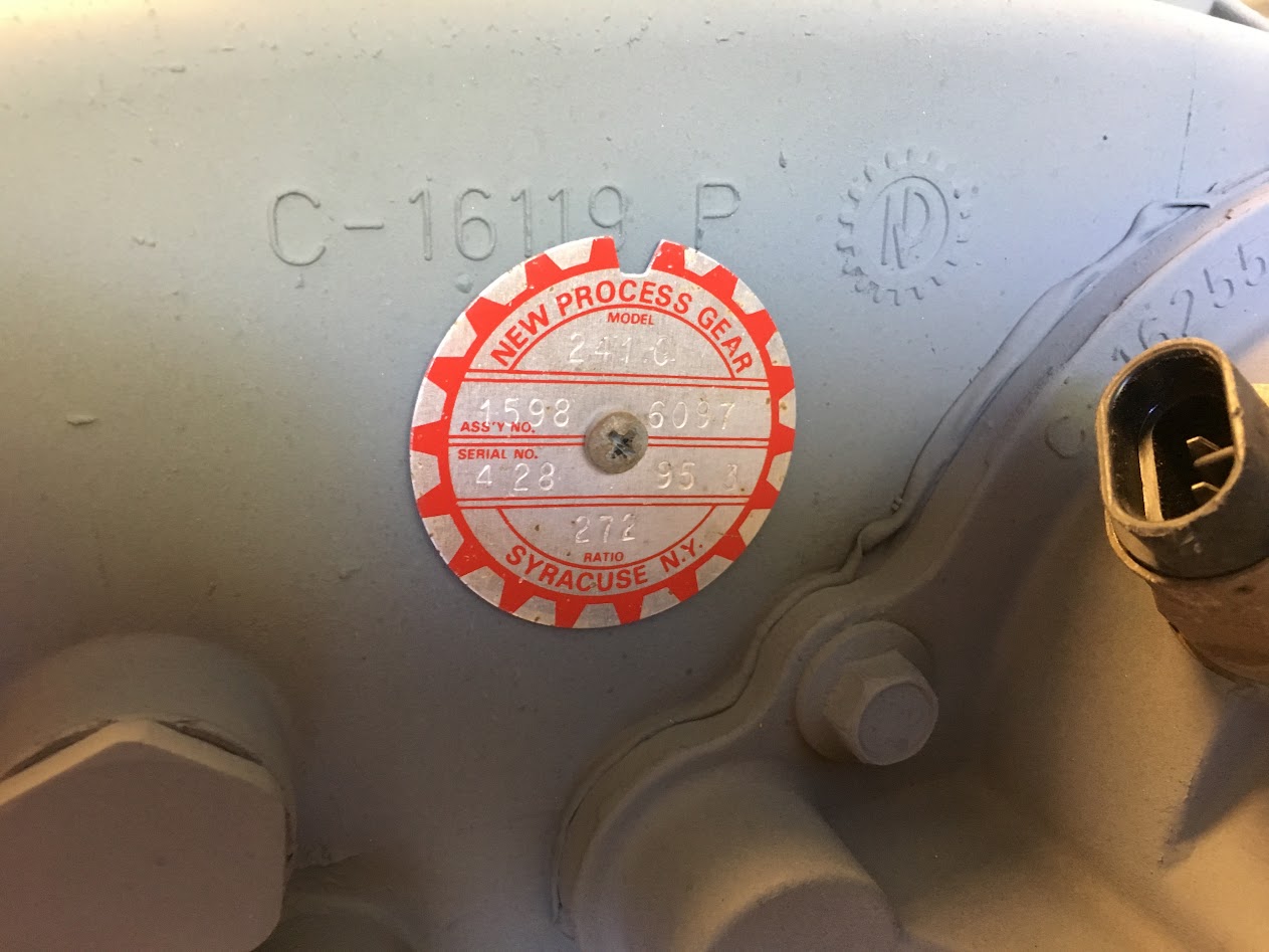

Picked up the 241C today. Looks great and feels nice and tight. I threw some paint on it and then remembered I have to tear it down to install the SYE. Keen eyes will see the adapter is wrong, that's one for a 241C/4L60E. Still have to get a 4L80E adapter.

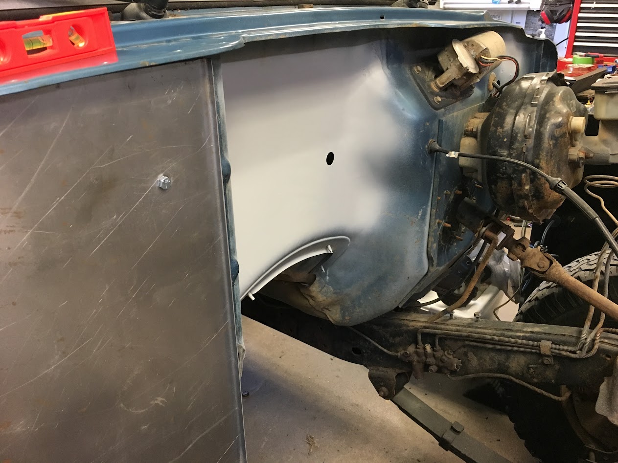

I actually worked on the J-20 today! Started on the firewall. Welded up the plethora of small holes.
I decided I didn't like the swiss-cheese nature of the passenger side, especially since the Vintage Air unit is going to hang there. So, I got a piece of 16GA bent up, and I trimmed it to fit. The bend on the edge is for stiffness, and to copy the stiffener panel on the other side. I still have to bend the flap hanging down to match the lower firewall, but so far so good. The stiffener panel will be attached with body panel adhesive. The two bolts are where the A/C unit will hang.

Got the lower edge contoured to fit with my home made bender. Now for the panel adhesive.
I still have to weld in the little notch in the lip too.
