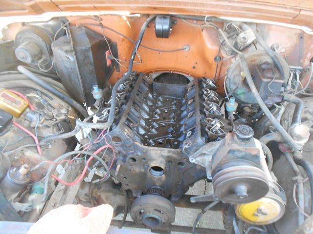

After getting it home and stuffing her into my tiny shop I removed the hood, grill, headlights and up on jack stands to remove wheels and tires.
Removed and cleaned oil pan and pick up tube.. wow! pretty mucky.

Cleaned things up best I could.. block, timing cover, etc.... new oil pump kit with Bulltear bypass plug, new water pump, timing cover re-installed.
