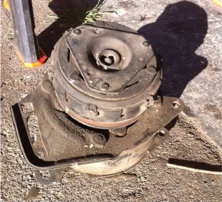

Well this is what I have, and I have no idea what it is ... other than it came out of an old Cougar.
Any one know anything about this?

Looks like an old Frigidair unit, made by GM. You'd need some way to lube it, just like the Sanden. Other than that, I don't know.

Yorks have their oiling built in. The crankcase is also an oil pan.
Sandens and Frigidairs don't have that and need a separate oiling system installed.

I really dont want a bunch of "junk" under my hood... so maybe Ill find a York ... if indeed they really dont need an oil tank to feed them.

I wouldn't bother trying to mount that thing up either. Find some brackets at a junkyard and a york and be done w/ it.
