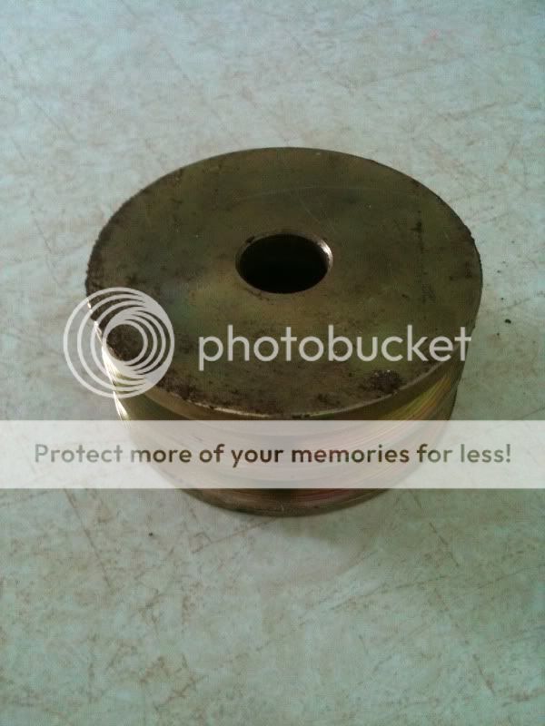

OHHH ok. Yes your right the belts is really not in contact with that pulley very long.
Those look great, is that the biggest you would go?
-Both of those are for diesel engines and have an inner diameter of .669". Would that even fit?

At the bottom there is a phone number call him he will hook you up the first one is exactly what I have they have hundreds of applications.
Notice Title says GM applications all diesel in GM land have 144's.
OK thanks for the info I didnt know that.
