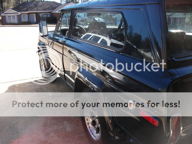

This is the sort of look I am going for, maybe a touch higher. I say "look," but what I really mean is height. If I need to widen the Cherokee W/T flares to accomplish this, I have no problem in doing so.
Originally Posted by jeepskater433
Vehicle: My old 1979 WT Cherokee
Tire Size and Make: 33/12.50/15 BFG MTs
Rim Size and Make: 15x10 Pro Comp Alloy Rims
How Much Lift: none
What Type of Lift: none
Did you had to trim your Wheel Openings: No
Any Rub: A little at full turn
Ristow, do you have a link to a pic of your Cherokee? I cannot seem to find it on here.
