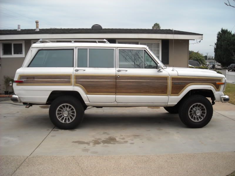

Just to give you reference, this is my Waggy on 30x9.50s with the 3" lift.
Rev.
Yeah, that's really higher than I'd like to go...
I think I'm going to try the used J10 spring idea first. I may be relieving my bladder in the air circulation device, but we'll give it a shot. Depending on where that gets me, I'll decide if I should stay or go 2" BJ's...

Your tire fitment issues will be at the rear. NT wheel wells are not as deep and you cant fix it with rear flares. It might look better with a set of Tall Skinnies (33x10) that wont stick out past the rear door and fenders--Just my opinion.
I am not sure what you mean. Are you saying they are not as tall, or that they don't go in toward the center as much? If the latter, by going with the J-Series rear axle, and a flare (which I can widen if need be) and cutting the rear quarter to match, I should be able to make more than enough room.

The measurement in between:
1) rear wheel wells distance, inside to inside;
2) rear wheel to wheel distance;
3) rear spring packs/perches/mounts inside-to inside;
4) rear frame rails inside to inside...
Are ALL narrower than in a J-truck.
The rear-wheel well is much too small to accommodate a 33"x12.5" tire without rubbing if using a J20 axle.
I had a 30x11.50 Swamper TSL on a 15x8" Chevy/Jeep Rally wheel and I mounted it on the rear of my 1976 Wag before I transformed it into a 4-door Wagoneer w/ J20 axels...it was tight. The J20 axels are 8" wider. You will have to cut ALOT of inner wheel-well out and re weld it to the body-side-wall inside to fill any gaps...before you add truck flares.
I have to do the same thing, except I increased my wheelbase from 108/9" to 115/6". So my rear Wag wheel-well is a bit funky right now in mid-project.

Ah, OK... Well, yes, a large portion of the quarter panel, and the adjoining inner fender will need to be cut out to accommodate the larger tire/axle combination. And I'll need to move the spring perches on the J-axle to be able to bolt the thing in.
I don't mean to be flippant, but I didn't exactly think I could just stick the flare on the outside of a Wagoneer's quarter panel and be done with it.
