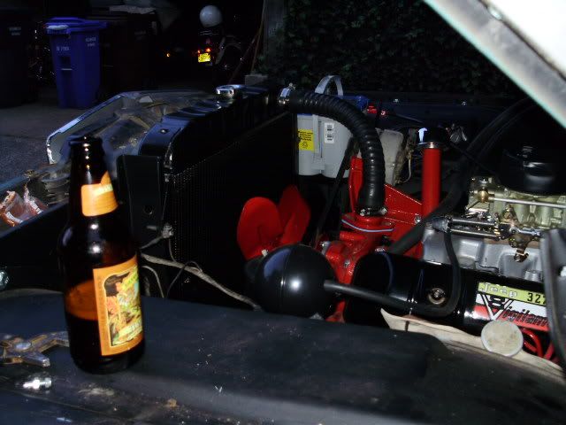

Got my radiator back from the shop today. Had to have it recore'd and it looks great! Here's some pics. All that's left before I can get it running again is a fuel filter and wire up the electric choke for my Holley. I'm so close
Installed, but getting dark so not a great shot...

SWEETNESS! Please youtube some run time on that 327 when you can. Looks great.

Drooool - that 327 looks amazing!
Where'd you get the valve cover stickers?

I ordered from this guy, http://southtexasamc.tripod.com/osbdecal.htm
There are some listed on ebay right now, not sure if it's the same guy, but you can search for Jeep 327 and they'll come up
