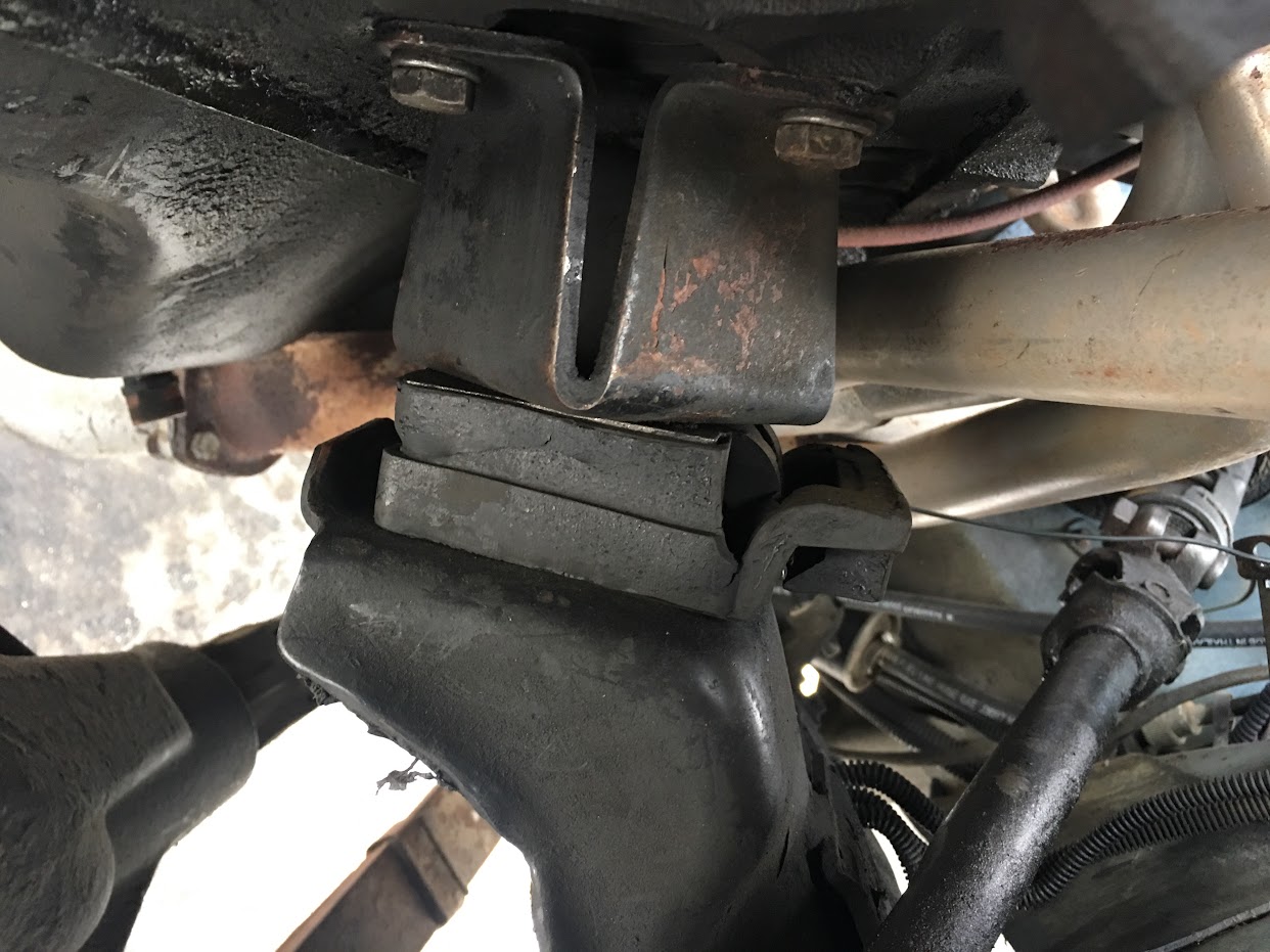

Took it for a test drive, all seemed well. On the way home, you guessed it light came on again. Stayed on all the time again.
So crawled under the truck and it appears to be the RR caliper.
Appears the seal blew out and it's leaking from the adjuster arm shaft.
