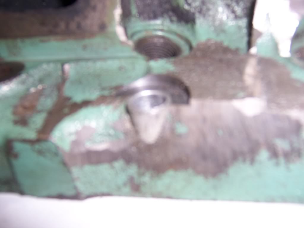

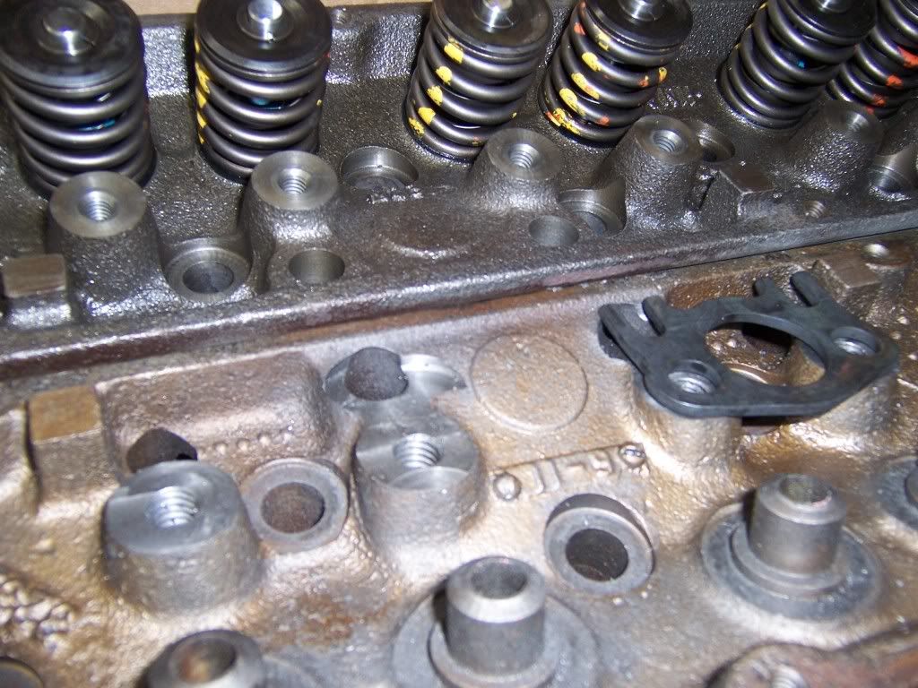

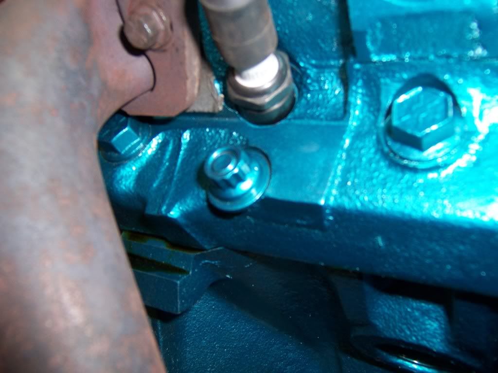

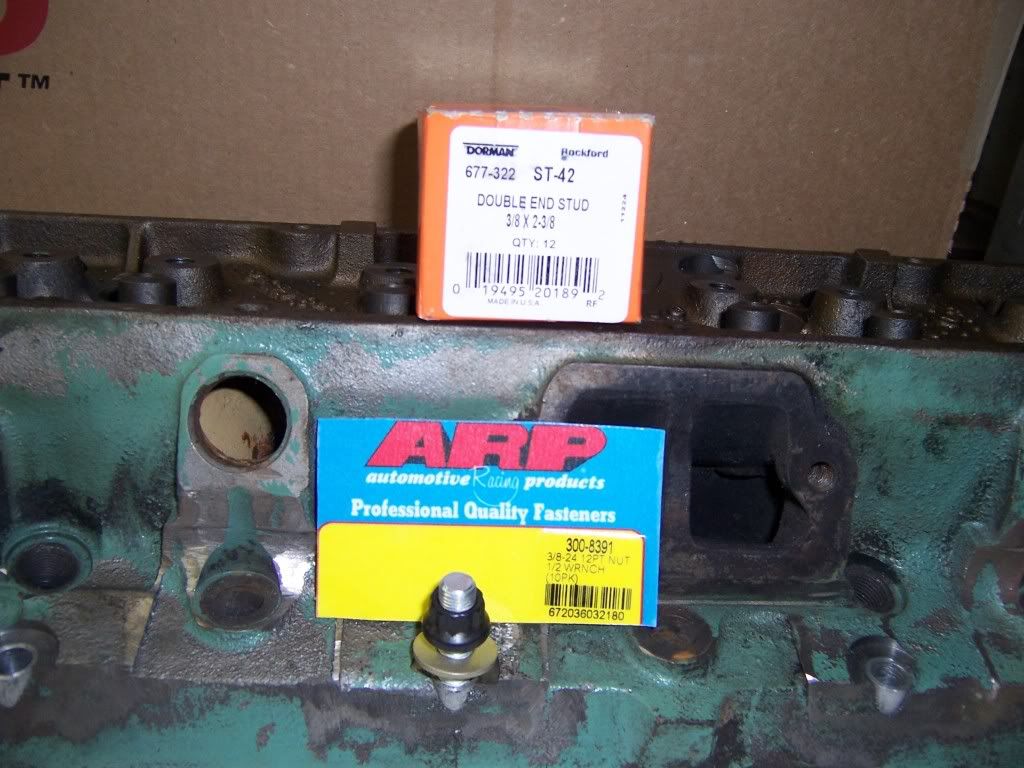

Ghinmi had sent me a couple of PM's asking me questions about the heads. Sorry about backing up here but I post up some of the details now...
Rocker Stud conversion:
The Heads were originally the late model bridged rocker type. The bosses for the 5/16" rocker arm retaining screws were milled down about .330" to allow for guide plates. The area on the head where the guide plates guide the push rod had to be milled in 2 different spots as well. Then they were tapped for the 7/16" rocker studs.
Extra 3/8" Head Bolts:
This has been done a few ways but Stickshifter (Kevin F.) and I decided to do it this way.... We drill a 3/8" hole through the head. Then we counter bored from the top down to within about 1/4" of the bottom surface of the head. This allows us to press fit a sleeve in to the counter bore. A spot face goes on top to allow for a flat surface and a hardened flat washer.
I finger tight the studs in to the block with RTV before I put the head on. I tighten the 3/8" nuts to 30 #/ft.
Stud: DORMAN 677-322 ST-42 DOUBLE END STUD 3/8 X 2-3/8
Nut: ARP 300-8391 3/8-24 12PT NUT
Washer: It is actually a 5/16" hardened washer from ACE.

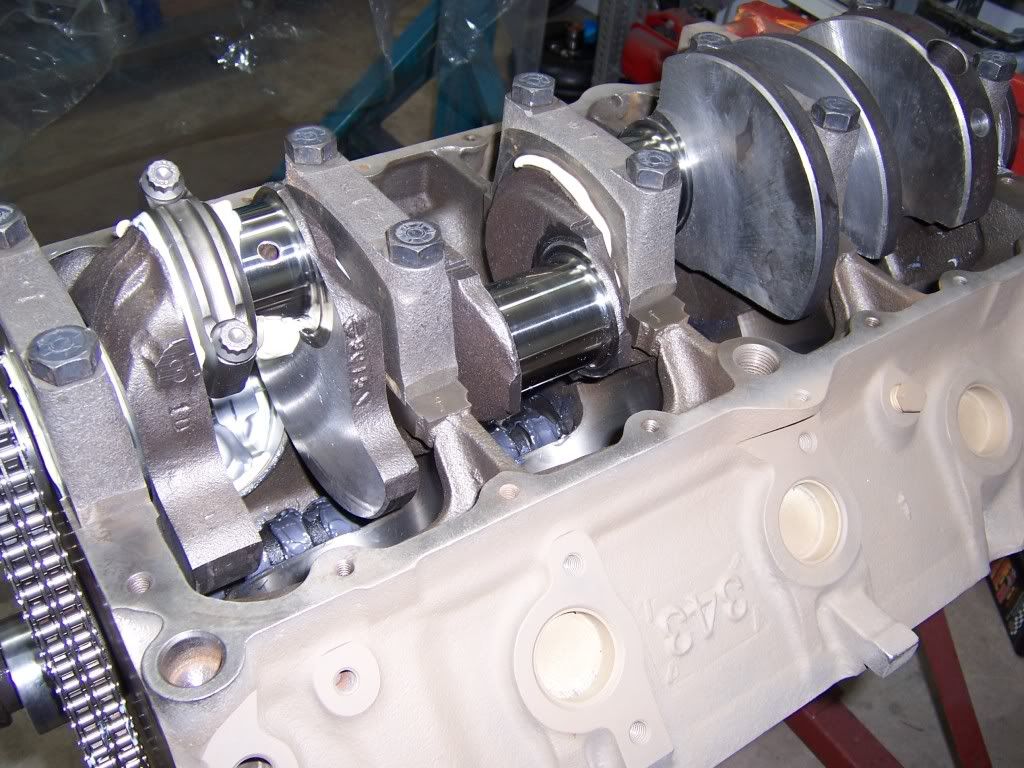

"So I thought that the 360 stroker was awesome, but a 401 stroked to 429? Does a Jeep get any more testosterone inducing motor manliness?! Gotta see it!!"
Well, I thought it was going to be a +.045" bore (4.21") but it ended up cleaning up at a 4.203" so the cubic inch will actually be 427.3. This one is geared toward racing and the guy wants a external oil pump and a crank trigger. I haven't built a engine with either but, I will figure it out. Anyway, I have a second street engine that I will be building with a +.030 401 bore and a 3.85" stroker crank. This will be a 425.7 cubic inch engine that has to run on pump fuel. To me, this will be the wolf in sheep's clothing type of deal... Both will be fun and hopefully we can dyno the first one to tune in the carb and to see some numbers. Once I get something going together on the first one, I will post up a progress report. In the mean time, I am currently building another 383 stroker. This time it is inside a 343 block.
