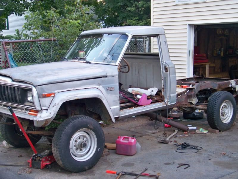

hey guys i am new fsj owner.. ill give ya the skinny on my truck, i found my j20 from a guy that didnt have time for his project .. i asked how much he said 4 bills.... i said sold, sight unseen, i go to his house and he says hasnt run in years so i hook up the battery and fuel lines and fire it up and drive her home.. cab all unbolted.. no floors.. so i had the idea to use its axles for my zj crawler.... dana 44 and dana 60 sounds nice in a zj.. but i sat on my steps and got to lookin at her... two days later my zj went to the scrap yard and this is what i start with
so heres some photos tad wanted and a little of the build up.. so far

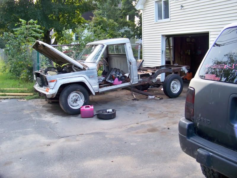

back half is lifted and cab still just sitting there...
rb shackle flip
soa kit in front shot
big tires on 38.5x15
i got tons more pictures, but ill save them for a legit5 build thread.. anyways 5.28 or 5.29 gears 360 mated to a torqueflyte 727.. more to come

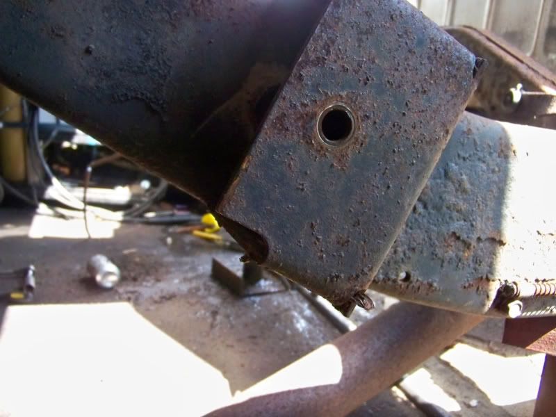

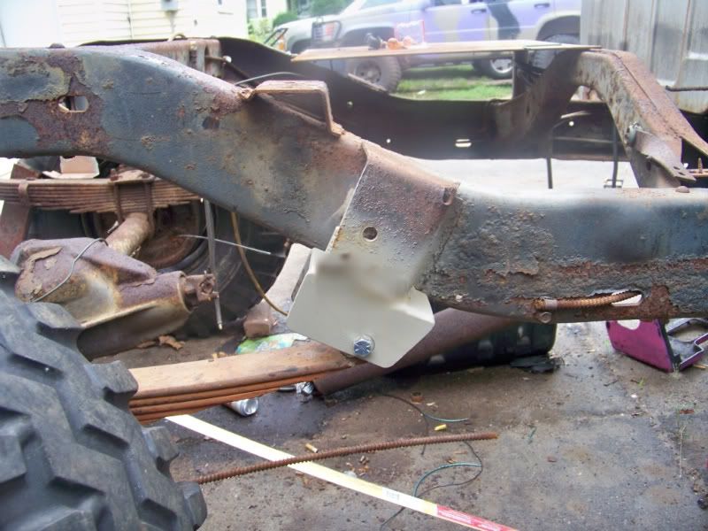

oh yea tad rear perch before mod
after
front mount
and omg my wife delete the after one grrrr anyways cut it about 3/4 of a inch at the same angle as the lowest piece on the bracket and it should work out fine

Welcome! I saw the first pic and thought, "you drove it home like THAT?!" then I scrolled down...lol
Justin
'72 J2000 360 4bbl T18 D20
'96 ZJ
Old 09-04-2011, 08:30 AM
off kilter off kilter is offline
Join Date: Jun 26, 2011
Location: mass
Posts: 109
yes i drove it home like that first pic...was a mile from my house...right through center of town....no radiator and all...i coasted much of the way engine off...ill resize pictures when i can get on a computer later....i cant do from my phone

Actually I have never gotten any good LB kit pic's back and was hoping I could revise the install directions.
This one should work:
Thank You off kilter
You might as well use this as a place to ask about your body mounts too.
Looking at the Chero frame out back and something tells me the JTruck configuration and placement is different.
Old 09-04-2011, 09:36 AM
Posts: 22,054
I guess I never realized the spring mounts are moved back on the extended frame for the LWB. (maybe I didn't say that right, whatever) It appears the rise in the frame for the axle may be the same location as the SWB frames. Yes?

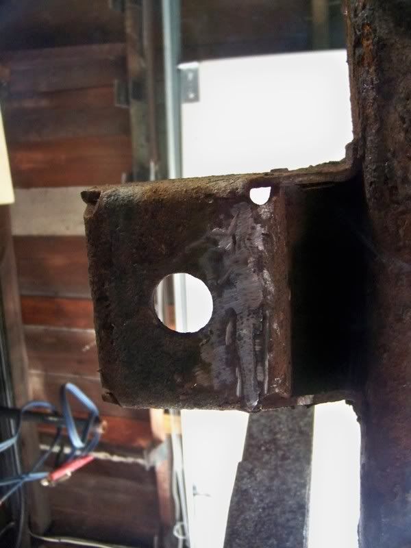

there ya go these are a little better not fully bolted in thats tomorrows project
Old 09-04-2011, 10:17 AM
Location: mass
Posts: 109
the rise in the fram is in the same spot but swb trucks the front mount for the rear springs is before the rise

You might want to check the diodes on your welder, those welds look kinda fuzzy.
Sorry Tad! I assumed, and we all know where that gets you.

lot of grinding and rewelding and grinding then paint, to try and smooth it out plus my greasy hand marks on paint aint helping
