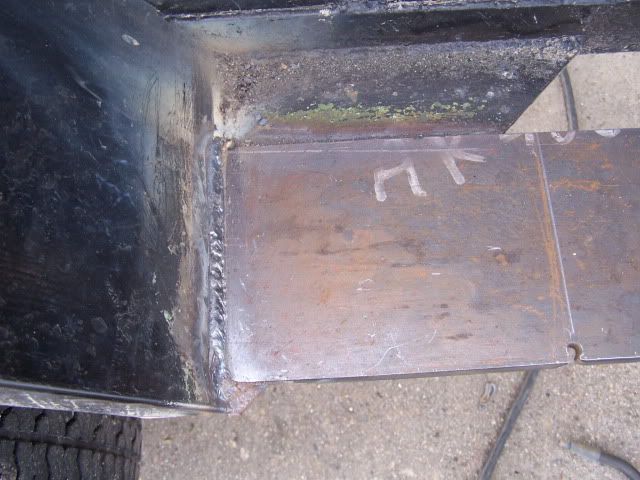

the next step was to re-inforce some stuff... so that i didn't have to worry about dragging it across rocks and whatnot...
a 1/4" thick Hardox armor plate (courtesy of work) for the ammo-cans to sit on (can't be drilled unfortunately...)

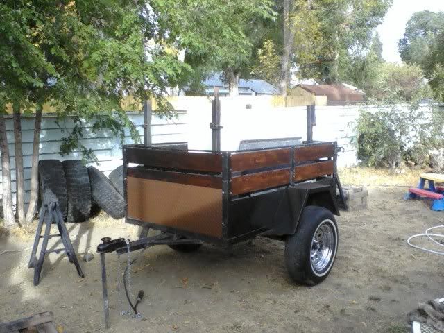

starting to really come together...

Nice!
tell us more about the armor plate

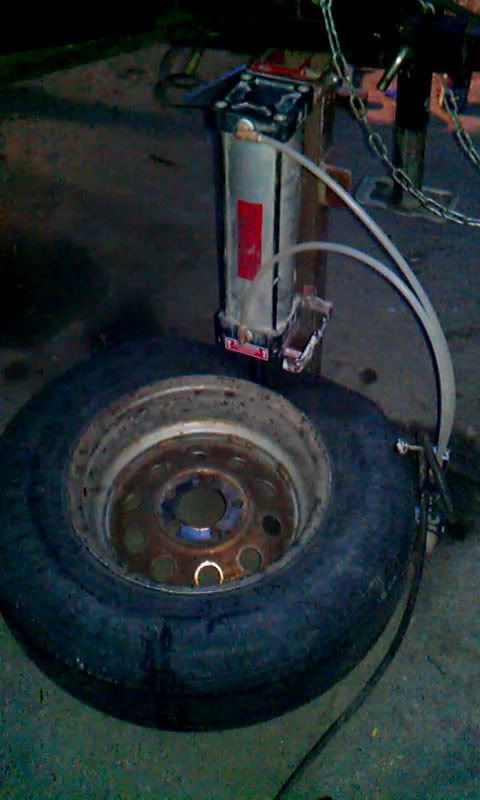

still alot more to do... but she goes anywhere i can... so it's a success so far...
my little bead breaker... just for fun... since i change my own tires.. (gotta love garage sale finds)

Old 07-10-2011, 04:46 PM
That looks like a very handy trailer. Nice find and work.
we use it in haul truck bodies at work... has to be cut with a plaz... these were some test plates that one of the guys at work gave me... it's some super strong, super hard stuff... not really structural but it'll take one helluva hit from a rock before it'll even leave a scratch...

very cool. cant believe you got that for free. How do you balance your own tires?

actually... everything except for the bolts for the leaf-over, and the ammo cans has been free...
at that point... i just don't bother... i've run them down the road at 75 mph with no problems before... if i get a bad one eventually i'd like to try a trick that i've heard about... but i've never needed it...
