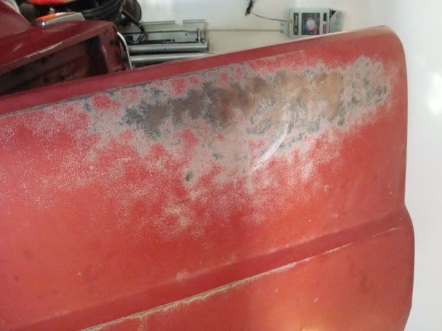

What grit sand paper should I use? The flat black thing did cross my mind....
This is what I am dealing with...

I'm dealing with some rust issues right now also. Doing the whole truck though. I had a lot of surface rust that turned out to go pretty deep into the metal. Mostly just small pits but htey went in a little ways. I'm trying the rust neutralizer also but have used a 50 grit flap wheel on my angle grinder for some big stuff. It can take quite a bit of metal aff if your not careful but is way better that a hard grinder disc or just trying to sand with paper. Give it a shot if your rust goes too deep just blend it out by hand after the wheel the prime it. Good luck!

you could knock that down quick with some 220 on a palm sander up to the line where the center rises up, spray with the orange Rustoleum Heavy Rust Primer, give that a sand with a higher grit, and rattlecan it.
I like the Heavy Rust primer because it's thick and fills in a lot of scratches. Check out this thread if you want to see the wonders of rattlecanning on an FSJ

The only problem is that rust can waste sandpaper - do the scotchbrite/scuffpad/steel wool thing first and then wipe it clean with some solvent or paint prep.
Then start with a medium paper, not coarser than 80. In fact, i would say start with at least 120 and if it is going too slow, then try the coarser. Wipe it clean, and if it looks to scratched up, go over it with a little finer grit. Prime it, spray it, done. If its auto paint then you could color sand and compound it out... If its enamal you're really done. Trust me, you can't sand it (don't ask how I know)

I suggest sanding it with 80-100 grit sandpaper then using some kind of rust treatment or neutralizer, (sanding will not get all the rust out) then some high-build primer to fill the rust pitting. Sand/block it off to smooth it out and a coat of regular primer/sealer on top. Then paint it or whatever. If you want to do it right and you have an air compressor, get a spot blaster from HarborFreight for about $15-$20 and sandblast the rust off instead of sanding and rust treatment. High-build primer, sand, primer/sealer, paint.
I like the sand blaster idea. What media should I use, just sand, or is that too agressive?

That doesn't look too bad. Clean it. Then I would use 120 grit sandpaper on the area. Clean area with indurtrial cleaner.Then spray primer. Then spray your car color if you can get it.

Hit it with the DA sander, maybe 220 grit to start, if deeply pitted, you could spot blast, it or if you want to play Dr. science use the electronic rust method to spot remove the oxide (usually you dip the part in the vat of washing soda, but a sponge soaked with washing soda between the sacrificial plate and the body panel should work fine also. ) Or there is always the scrubbing with phosphoric acid (metal prep) it will slowly eat the rust.
from what I see, that is nothing, a quick once over with the sander and I bet it is looking good.
