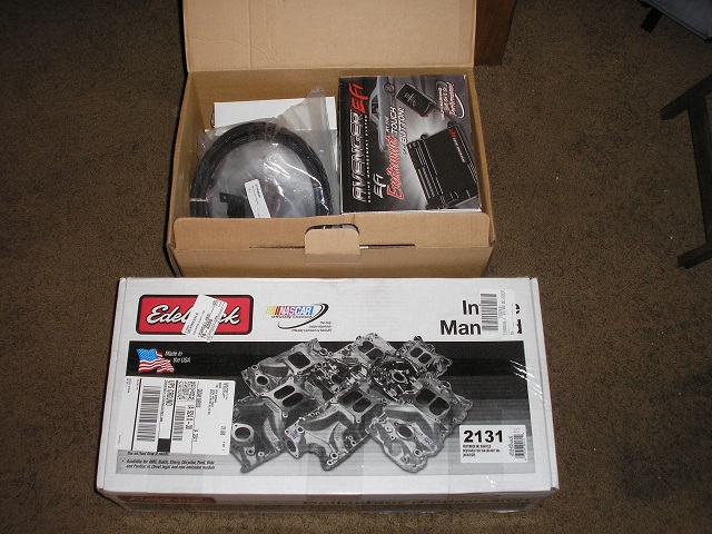

So I've got the major batch of parts in. I might as well start a thread.
It's going to take a couple of weeks before I start the install. I have to do some more prep work and wait for a couple of parts that I forgot to order (like a valley pan gasket)
But here's the first set of boxes.

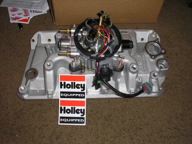

I had to put something together...

Obviously, the manifold is the Edelbrock 2131. Performer non-EGR.
The FI system is the Holley 550-400 unit. It's the 4bbl unit for 200-400 HP. Should be just right for a mostly stock engine and exhaust.
