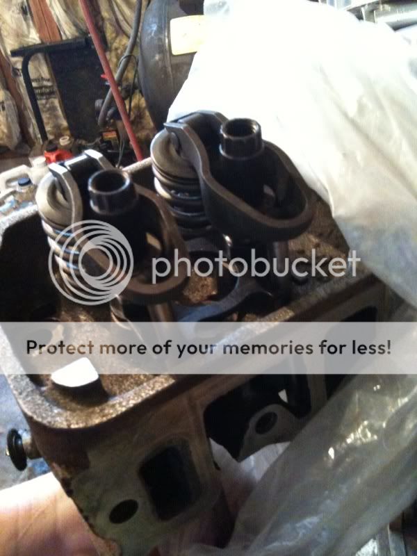

got a second set of rocker arms in today. i wanted a 1.7 / 7/76" stud arm. couldn't find one....until 2 days after i bought the 3/8" stud comp cam knock-offs!
this second set are PVS mid-lift arms. look good. clearance priced at 40.00. i got the poly-locks too,60.00 total.
these are stamped,not cast like the comp cam style. look nicer made too. the tops of these arms are measured against the stud at mid-lift on the valves,it will be 90 degrees when properly set up.
look how much bigger the fulcrum is.
mocked up.
